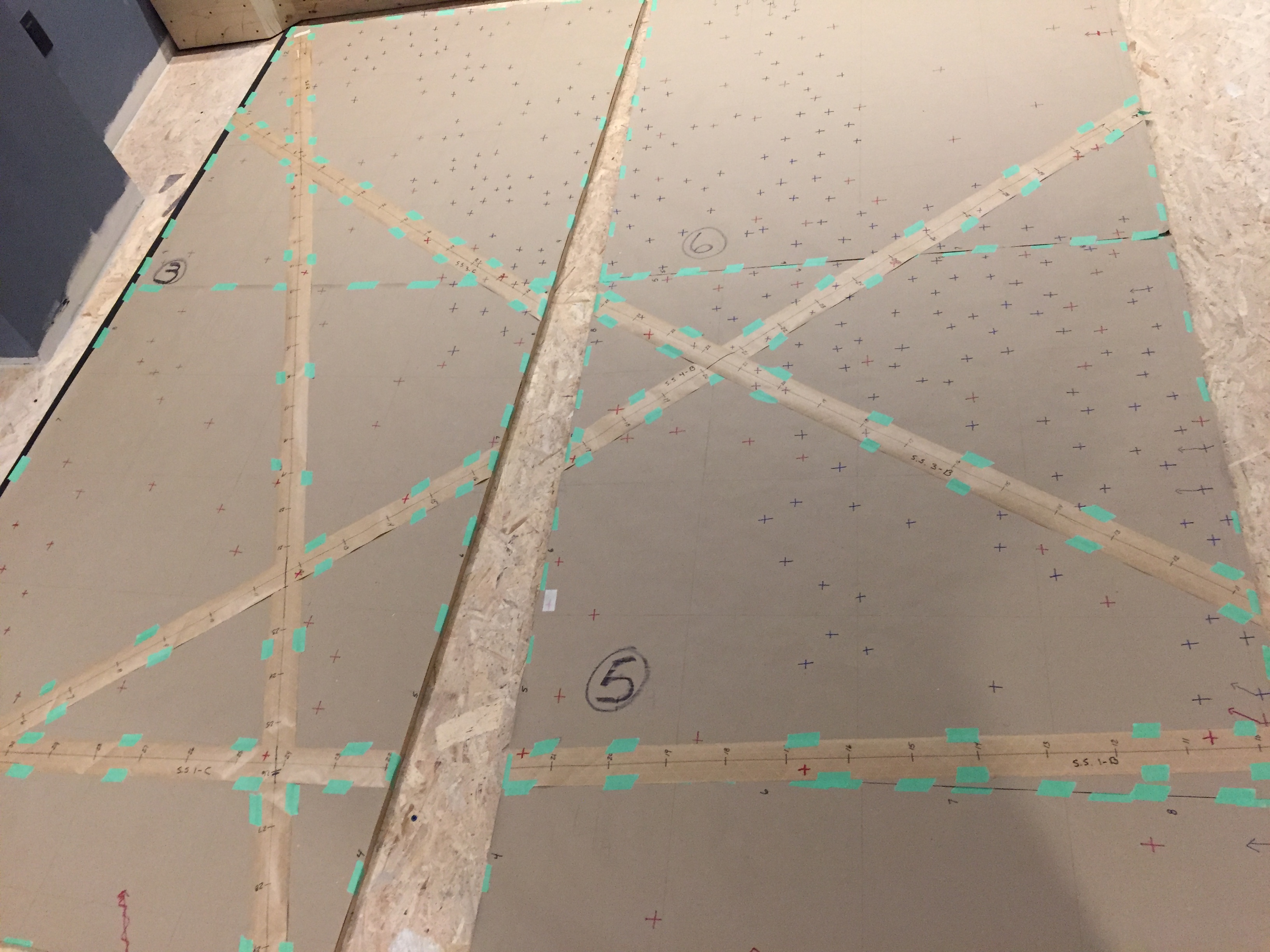

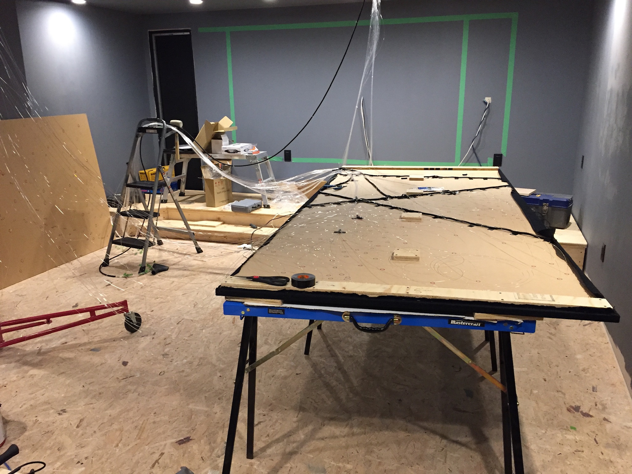

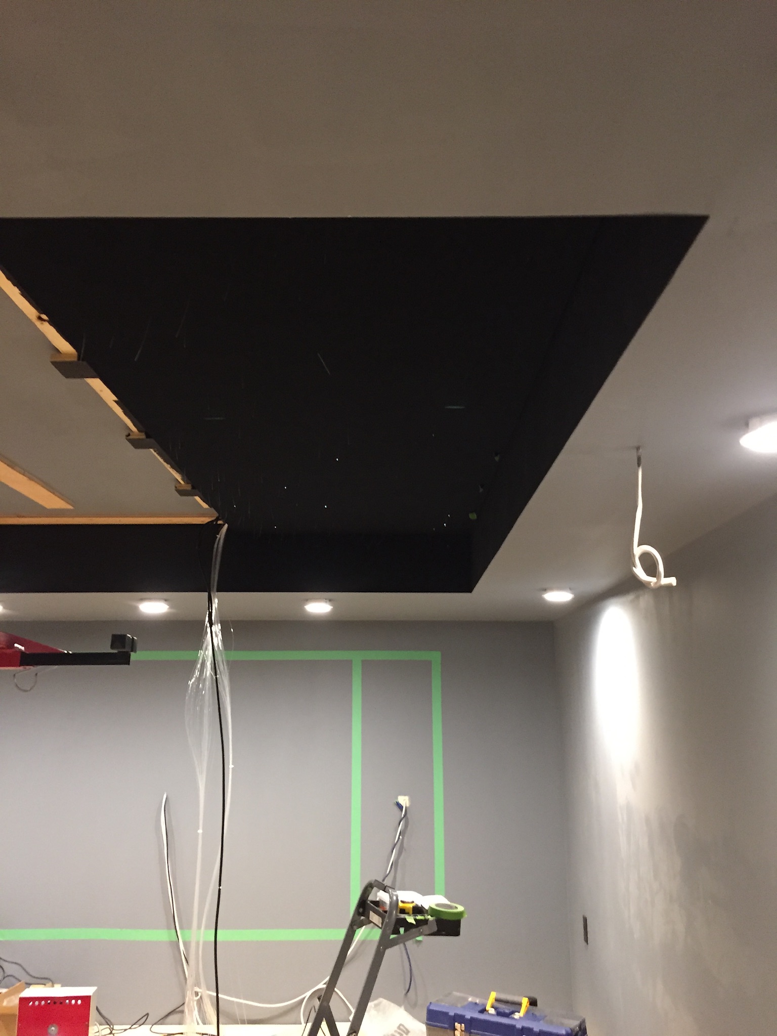

Woah!! How did you get that roof…
Hi Mark, I built it from scratch with MDF boards, fiber optic cables, a light source that animates the stars to look realistic and black fabric. Each star is a separate run back to the light source so it’s a LONG process (took me 3 months from start to finish in my spare time LOL). There’s over 3 kilometers of fiber optic cable in that ceiling! No regrets! I use it every time I’m in the theater. It’s also an accurate star field so it has constellations (which blink convincingly) and static Milky Way stars that are dimmer in the background. I also added some shooting stars that shoot across the ceiling from time to time. The stars are also on a separate switch so that the stars can be dimmed without affecting the motor that runs the animation for the stars.
